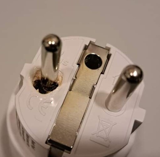

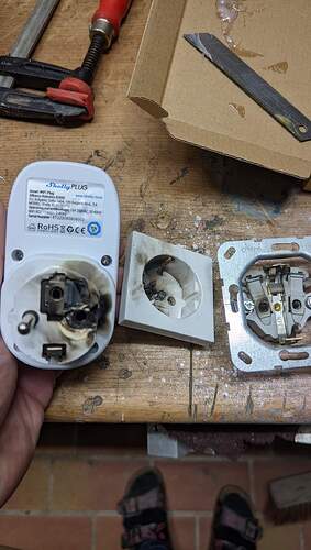

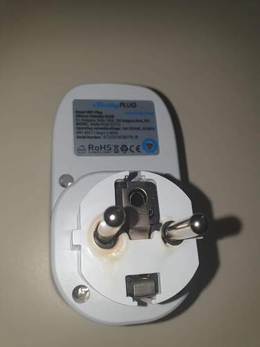

Shelly Plug S - Habe Angst, dass er mein Haus abfackelt

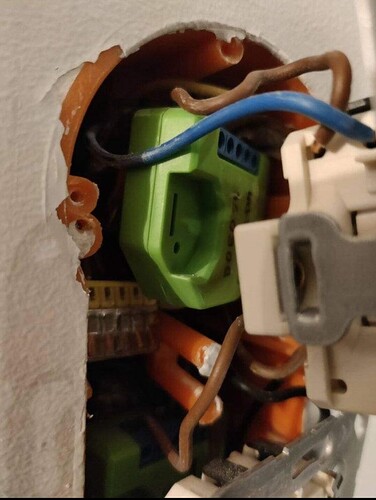

Dear readers,
What is de warranty on a fibaro double switch ? I would expect it to last at least 5 years. But in my case, I had a FGS221, installed in a wall switch for controlling a small about 10 Watt LED bulb. I have installed it 3 years ago.
Last week, the fuse blew out in the central fuse box. The cause was the FGS221, it had completely burned out. Even dangerous for causing a fire, luckily it was installed proberly in a protective junction box.
I would not expect this, small load, normal use, should last a lifetime I would say.

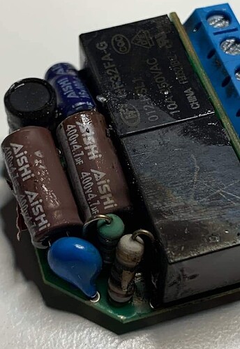

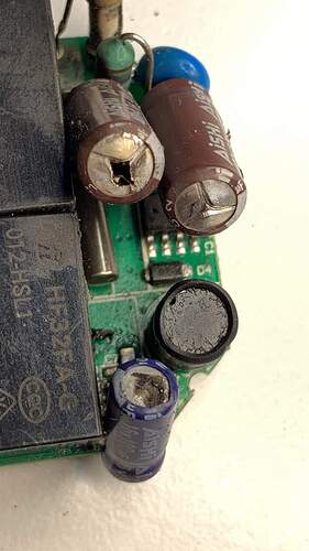

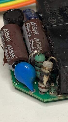

Hi! Have been living in a newly furnished apartment for almost 3 years. I have 30+ Shellies - Shelly1, Shelly2.5, RGBW and Dimmer (some replaced with Dimmer2). During last ~6-8 months Shelly Dimmer started failing, they all make hissing sound when they fail, which I assume are capacitors. Nothing directly visible after opening. Other types of Shellies - no issues. No known voltage fluctuations.
What is your experience with the longevity of Shelly Dimmer? (1st gen, with Neutral).
(No intention to start a flame)

Boiler hat 2500Watt, laut Shelly nie über 1900 Watt. Dennoch ist der Kontakt vom Shelly geschmolzen.
